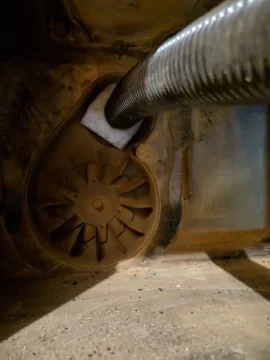

No need to take the venting apart, run a brush through what you can then find yourself a piece of packing foam cut a piece to fit snug in the exhaust passage at the left bottom side of the burn pot then cut a round hole in the center of the foam for shop vac hose to fit snug then blow the exhaust out with the shop vac on blow mode. Very easy to do and it cleans out the entire exhaust path .The pic gives an idea what I mean but it's on my Harman but I just cleaned a Serenity for a friend and done the same thing. [Hearth.com] First pellet stove sweeping

No need to take the venting apart, run a brush through what you can then find yourself a piece of packing foam cut a piece to fit snug in the exhaust passage at the left bottom side of the burn pot then cut a round hole in the center of the foam for shop vac hose to fit snug then blow the exhaust out with the shop vac on blow mode. Very easy to do and it cleans out the entire exhaust path .The pic gives an idea what I mean but it's on my Harman but I just cleaned a Serenity for a friend and done the same thing.View attachment 240746

I wonder if there's an upper limit for which units can be done this way. My Accentra insert leads to 16' of vent pipe up the chimney. I'd love to try this.

16 ' is a long way to try and blow with a shop vac, I do it to mostly get the section of exhaust that can't be gotten with a brush and on a Serenity it blows out the area where the exhaust blower is. But hey it's easy enough to do so why not try it.
