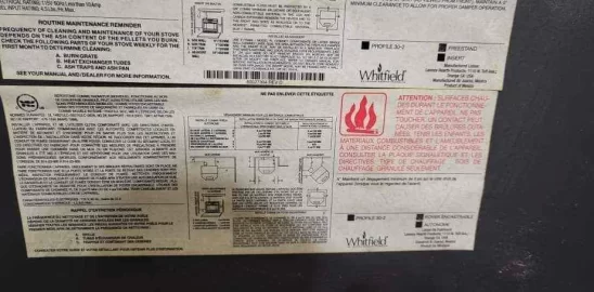

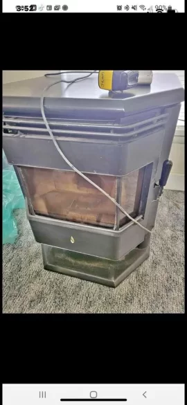

Tag did say profile 30 but cant see any numbers clearly in photo. Sounds like the same stove?
There are 2 versions of the profile 30, but little differences. Good stoves, basic functions.
Reactions: Sono

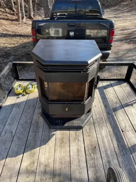

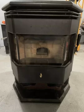

Here are pics of what I know of it so far
[Hearth.com] First Pellet stove [Hearth.com] First Pellet stove
Make and model would help. I would bet it is a whitfield, as you said "eye", and before you buy a new eye, there are cheaper, and sometimes better options.
Thanks bob. Advice without knowing what stove it was happens here alot.

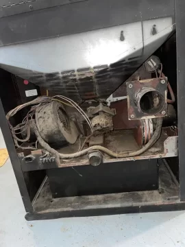

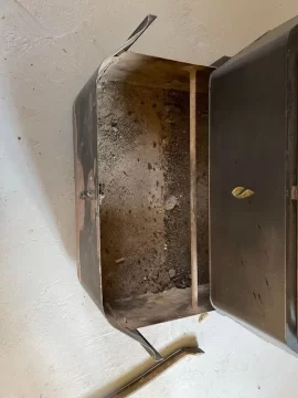

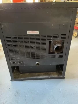

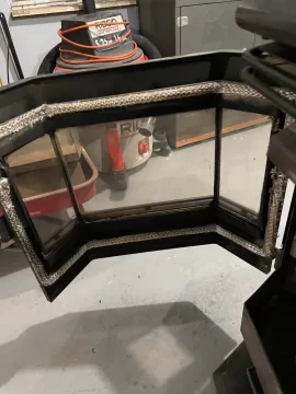

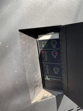

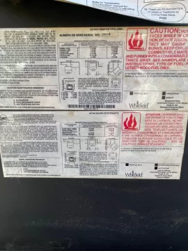

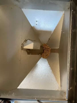

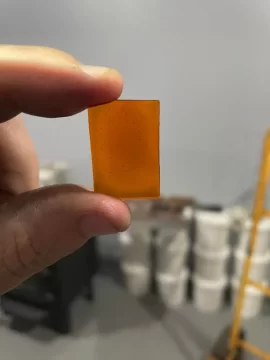

OK, got it home. Whitfield Profile 30 INS-2, Has the eye inside the hopper. All glass is good just smoked up a bit. The story on it is the mother that used it ( an elderly woman ) always changed the eye and igniter every time it quit working. This year the daughter surprised her with a new pellet stove. So, it worked until it quit again. Before I throw any money into it I will clean the eye, the lense and see what happens as it may just be dirty/dusty lense or eye ? First I ned to drag it down to the garage.
** update , more pics and also have the owners manual ! **
[Hearth.com] First Pellet stove [Hearth.com] First Pellet stove [Hearth.com] First Pellet stove [Hearth.com] First Pellet stove [Hearth.com] First Pellet stove [Hearth.com] First Pellet stove [Hearth.com] First Pellet stove [Hearth.com] First Pellet stove
If the lens is cloudy,burned too bad, they are expensive.
When the eyes "go bad", they may not just fail. they can cause weird and strange problems, like shutdowns intermittently, even if stove was running for hours.

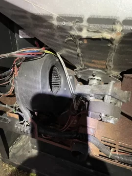

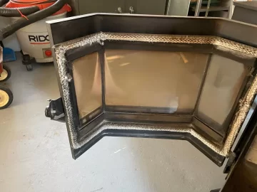

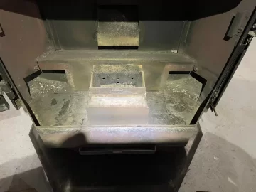

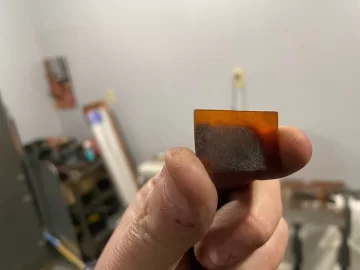

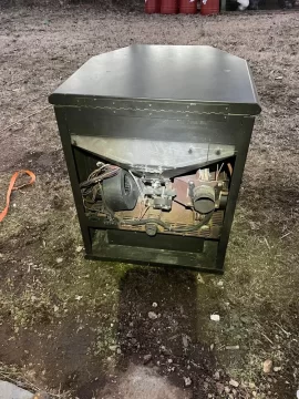

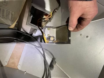

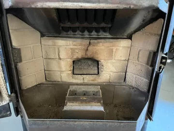

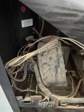

OK, The dustball has settled. Cleaned, Vacuumed, Blown, Vacuumed some more. Pulled everything apart, cleaned the photocell (eye) and it was clean surprisingly but the protective lens was charred, cleaned and re-installed, pulled the 2 little doors inside and vacuumed the ash out, cleaned the blower wheel of all the caked on dust, cleaned the motors, blew all the dust out of them...did the works on this thing tonight. Neighbor has a similar stove and will come over tomorrow or so with some pellets to see if it will fire up on its own now without any parts being replaced, if not I will start trouble shooting it.
Pics, Ill try to do before and after in order...if not then they will be scrambled.
QUESTION: on the auger motor it seems to be oily dust caked to it, would it be safe to use electronics cleaner to spray it off ( its made so not to damage any electrical components, leaves everything clean and dry )
[Hearth.com] First Pellet stove [Hearth.com] First Pellet stove [Hearth.com] First Pellet stove [Hearth.com] First Pellet stove [Hearth.com] First Pellet stove [Hearth.com] First Pellet stove [Hearth.com] First Pellet stove [Hearth.com] First Pellet stove [Hearth.com] First Pellet stove [Hearth.com] First Pellet stove [Hearth.com] First Pellet stove [Hearth.com] First Pellet stove
The lens was the problem,no doubt. It sure cleaned up nice.
Thank you, Once I get to try and fire it we will know for sure. I figured that lens was the issue just from research as she was replacing the eye and igniter every year.... we can all tell it was cleaned or maintained to an extent.
And a stiff wire,if you suspect anything.

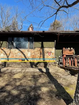

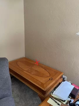

Nothing inside, clean as can be. I am thinking to direct vent this right out the wall since my house is on a slab, its a Berm style ranch home, so If I go straight out the wall and cap it I should only need about 4 feet of pipe, an elbow and the cap . As the book says it needs a slight rise per foot ( forgot what the actual measurement was ) so it shouldnt be too bad using a wall thimble as its a frame house but the exterior is stone faced where it will go out. For the window and overhang clearances I wouldnt be able to go up and out, just straight out level with the stove exhaust as there is a flowerbed below which are within the clearances but later will be poured over with concrete as I pour a concrete deck to replace the wooden decks that are rotted.
red X is about where it will exit inside, Blue line outside is floor level in house, Yellow line is flowerbed height where the poured concrete will also be. The red 0 is where the exhaust will exit and terminate.
It is always preferable to have some vertical pipe in any installation. It sure looks to me like you could go up then out, especially if you install outside air for combustion, which lowers clearances. One thing to remember, if you put in a hole straight out, and later change to a different stove, you will have to change that hole. All are different.
Reactions: Sono
The highest I can go off the floor is 4' due to the clearance needed before the overhang of the roof that would leave me right at the 3' max as I only have a 7' wall in the house there ( vaulted ceiling )
