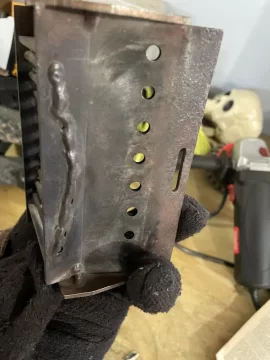

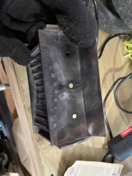

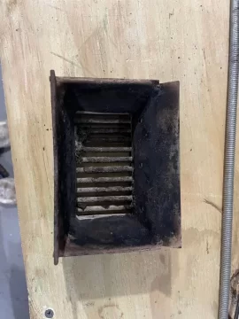

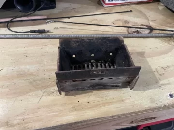

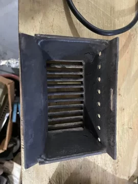

And I did pull the basket out last night and wire wheeled all the carbon buildup off of it... doesnt look new but looks better than it did, cleaned out the holes for igniter and air as well so it breathes better. Neighbor is busy today but hopefully he can make it over to test it out and make sure its working correctly ( as he has one similar )

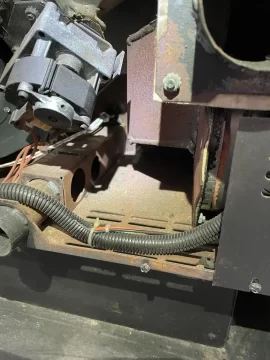

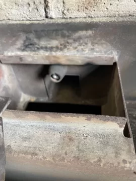

Ok, tried to fire up the pellet stove today ( put a jumper wire on since I wont be using a thermostat. When plugged in the fan runs. solid green light no heat or blower lights lit ( is this normal ? )

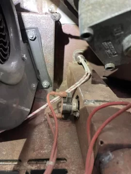

I press ON and heat/blower lights ..light up. But not getting a fire, no heat at the igniter when pulled basket out so I assume its the igniter and ordered a new one ( should be in Thursday ) I figured the eye is good since the sight glass was carboned really bad and igniter just probly burnt itself out with the eye not sensing a flame? surprisingly the igniter is cheap ($20) and the eye ($90)
Reading the manual it really doesnt say anything about the fan running when first plugged in and so Im confused a bit if its normal and the jibberish with priming the auger and all turn on 2 min, off for 5 min should fire in 8 min.... but the stove is never really off, the fan runs continuosly or am I missing something? And yes it is 30 degrees outside and Im trying to fire it up out the garage door to test it.
On most all pellet stoves, the combustion fan will come on when plugged in, run for a predetermined time, then shut off.
If yours does not shut off, you could try unplugging, unhook one of the wires to the eye, plug pack in, and see if it runs and times out/shuts off.

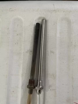

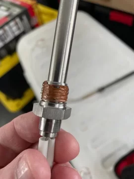

Alrighty... Got the new igniter installed and it works !

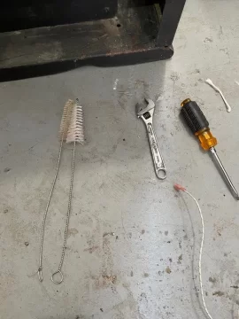

I have read where it says to install the new fuse that comes with it which I did after testing the old igniter which was dead, cold as can be even after 2 minutes.
I used my round brushes to clean out the igniter housing, just a little ash inside so wasnt terribly dirty. Anti sieze on the threads before installing. I was able to just reach in on the lower right side and plenty of room to swing a wrench without removing anything. Plugged in the stove and the igniter tip was glowing red !!!! So, now to get pipes and pellets to get this thing installed soon.
I did notice the igniter was about 1/4" to 3/8" longer than the old one, also it is all stainless steel ( no brass nut ) like the old one. so the igniter is closer to the tip of the nozzle at the basket. The other was so far back you couldnt see it from the nozzle ... guess this is better, it is a Whitfield igniter for this stove.

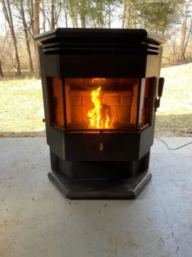

Picked up a bag of premium hardwood pellets today $4.99 for 40# bag. Took about 30 seconds for it to light, since the auger wasnt primed I just put a handful of pellets in the basket to start. It died down a bit but the auger finally started feeding and kept a nice flame going, threw out some good heat, I let it run about a half hour them shut it down ( was 70 out today ) so now that I tested it out in the garage Im ready to set up the connections in the fireplace so its ready for next season. I cant attach a video, but I was amazed at how fast this lit up with the new igniter, didnt fill the box with smoke like youtube videos show. Pretty flame at about 1/2 damper, high heat/med blower

Well done…your hard work and learning the stove will pay off for years to come!
Wasnt really that much work luckily, more or less just a good cleaning and replacing the igniter. I think Im going to repaint it as the paint is worn off in spots and looked to be burnt off the ash drawer front which I sanded and painted already. But I was excited that it worked properly.
