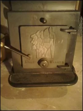

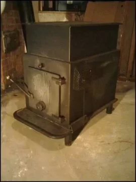

I recently inhereted the wood stove from my grandparents old farm house. It's a cast iron stove that uses a 6" flu pipe and has the infamous old man on the mountain embossed on the door. I was wondering if you all could help me identify it as my relatives do not remember where or when they had gotten it. I've attached a few pictures below.

as cool as that stove is, I'd get a new one for your home. Maybe you could put that old one in the barn or your shop or something??? I'm kinda new too but thats my 2 cents.
Firelion makes a good point, although that stove may do a fine job heating your new home, the new EPA certified stoves burn cleaner and heat more efficiently. Do you have an existing stove, fireplace, or chimney in the new ranch? If not, you might want to consider installing the heirloom and enjoying it's grace for a year or so (after it has been properly inspected for safety!), then possibly look at investing in a more efficient, environmentally friendly model next year. Whatever you decide, please make sure that you know what you are doing or call a qualified expert to assist with install and inspection. Good luck.

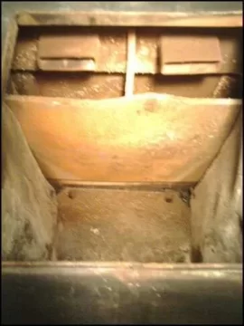

Greetings Adam and welcome, that is an interesting stove. Is there a baffle inside? What is the control on the upper right side for? As far as I can see this looks like a steel stove, not cast. That isn't necessarily bad, it looks well made.
If the stove is safely installed, it will make a difference and fans could help move the heat around. As you've noted, this is a long, narrow house. It's a tougher style to heat evenly, but with a central install, may be possible. We'd need to see a rough floorplan to help here.
Of course, a modern epa stove will likely eat less wood and will definitely burn cleaner. But if the stove is in good shape it may be worth a try.
I'd put an ad w/pics of that stove on every craigslist in New Hampshire pronto, and ask about a zillion dollars for it. Better yet, eBay, and let 'em fight over it. With the money I made from that sale, I'd get myself an appropriately sized modern efficient woodburner and do a first-class install in my home. Rick
hahaha.. Sorry it is a steel stove.. I just always have lumped all old stoves into the category of 'cast' and didn't really look at it.. Maybe I should rethink my intended major of Manufacturing Engineering ;)

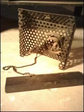

I've attached a few more pictures below in response to your questions about it. The first is looking in the door and upward to the ceiling of the stove. the second is a picture of the control which is mounted on the side of the stove. Its simply a metal spring that when heated or cooled pulls a chain controlling vent opening on the bottom of the stove. I thought it was pretty neat.
