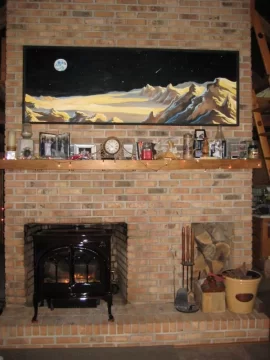

Recently installed my drolet 1800i and a chimney liner, and have been running some tests to see how hot I can get it, and in what time frame. I had trouble heating my home last winter, but have overcome a few problems. I now have a newer epa stove, my wood is seasoned to 20% with moisture meter, I have a block off plate and chimney liner. I also have a thru-the-wall fan blowing hot air out at top of living room to hallway, and I'm going to install one blowing cold air in from hallway to living room. My fireplace is interior and centrally located in my home. It got down to 53 degrees F last night, and I thought I would do a test. Also, I'm in SC.
I was only able to bring the house up 8 degrees in 3-4 hours. Does this sound normal? Stovetop temp was around 600 F when I reloaded and dampered it down 80% of the way. My draft pulls well. Moderate insulation in brick home, and single pane windows.
My general question is does the time of year affect how easy it is to heat a home? Based on barometric forces and temperature? I know a draft is stronger in winter, less humidity, etc. I've also read people can get their house in ranges based on outside temp. Like if it's 30F or above they can get it to 80F, it's it's 0F-20F outside they can get it to 75F inside, and -0F outside to 65F inside?

Its amazing how that room makes the stove looks so small. What type of wood are you burning (oak, ash, chestnut, poplar?)

Regarding that painting: It's an Edson Campos original I commissioned some 30 years ago.

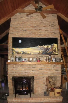

that massive (and very cool) hearth and semi recessed stove maybe sucking up a lot of the heat.
- (hearth in front the unit looks really short) -
Yes, the stove has a blower, and I packed my entire chimney around the liner with rockwool. It shouldn't pull out any of my house's air.
I am thinking a fair chunk of the heat put out by the stove is going into all that brick.
