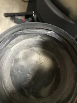

[Hearth.com] First time cleaning pipe. the is was my first season burning pellets, so I swept out pipe today. In doing do, o realized the rubberlike gasket at the clean out was misshapen in one spot, as shown in pic. I have a cleanout on the inside of room and outside a long my foundation wall. The cleanout outside was normal so I swapped them out (thinking I’d rather have something not quite right on the outside of house rather that inside right next to stove). I’m not sure what the lifetime of these gaskets is or if they are replaceable. Pipe is Ventis Pellet Vent.
Not familiar with that product,but good move swapping them out,Looks like the gaskets are replaceable,might want to order a few.
Will generic pellet gasket work or will I need Olympia ventis pellet vent specifically?
It’s going to be brand specific. They all make their connections different.
