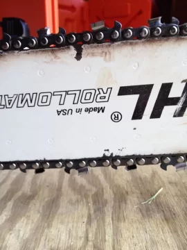

Here is the new chain. If I pull up in the middle by the weight of the saw this is the clearance I get. Too tight? [Hearth.com] First time sharpening chain...now it smokes[Hearth.com] First time sharpening chain...now it smokes
Is there any sag at all on the bottom of the bar under the chain when it is just sitting there? I just tighten mine up enough to almost take all the sag out and there's still just a little bit of space at the bottom. Can you spin it easy by hand?
I haven't found the size of the gap when pulling on the chain to be a useful tension indicator. Instead, I adjust it so that all of the slack is taken out and the chain lightly snaps back into place when pulled away and released. Typically I start with the chain hanging a bit loose, turn the adjuster until the chain just pulls up against the bar, move the chain along the bar several inches by hand, which distributes the tension easily and usually causes a bit more slack to appear, and then turn the screw a bit more to take out that new slack. You don't want it sagging off the bottom of the bar, but you also don't want tension that makes it difficult to draw the chain around the bar by hand.

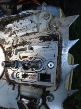

Ok put the chain back on. Here's the deal.

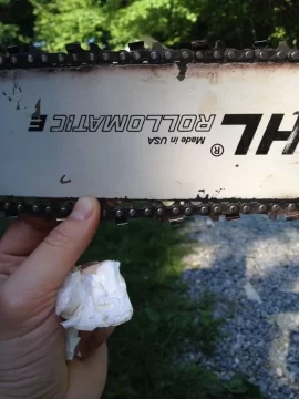

Took the chain off that was running fine. Weeper hole is nice and clean still and so was the bar. So unless the bad chain somehow clogged the bar more than the new chain I'm not sure that is the reason. [Hearth.com] First time sharpening chain...now it smokes

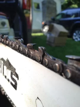

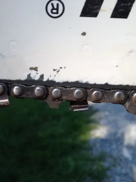

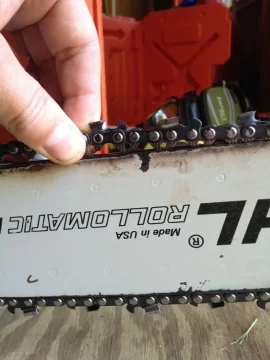

Here are some close ups of the chain. Same amount of slack I had before. Turns pretty easy without too much slack. And some close ups of the chain itself. I don't think I sharpened it too thin but it's my first time maybe I did. I haven't run it again yet to see if the issue persists. [Hearth.com] First time sharpening chain...now it smokes[Hearth.com] First time sharpening chain...now it smokes[Hearth.com] First time sharpening chain...now it smokes
It might be possible that your chain/bar picked up some dirt/chips after you sharpened, then got rid of them after you put the other chain on. The timing with the sharpening might be coincidental. My 250 will jam up the grove & nosewheel sometimes if I bury it in a soft cut. I can usually feel it happening, pull it out, give it some revs, and it will clean out again. I have never seen smoke coming from the chain/bar though, no matter how dull or jammed up it gets.
when I see smoke it is coming from the clutch not the bar or chain.
Definitely smoking from the bar. Usually the top of the bar stops digging altogether and then it starts slowing down and not throwing many chips and starts smoking.

What kind of tree are you cutting. I also notice the cutter doesn't have any "clean" shiny cutting edge like I am accustomed to seeing on my chain.
Reactions: Jon1270
It may not have a clean edge because I took it off after it cooled and then coiled it up and put it back in the chain box. Probably got it dirty in the process.

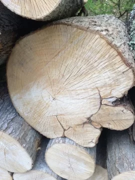

The cut is a hard maple. First cut about 2 months ago. Been sitting since. It's a biatch to hand split. My axe just bounces off most of the rounds. [Hearth.com] First time sharpening chain...now it smokes
I'm with bobdog; that chain does not look like it was sharpened only 1 minute of runtime ago. Dirt picked up while coiling it and putting it in a box doesn't explain that sort of discoloration.
It's hard to judge the sharpness, tooth shape and condition from that picture. Have you tried cutting with it again since it has cooled off?
