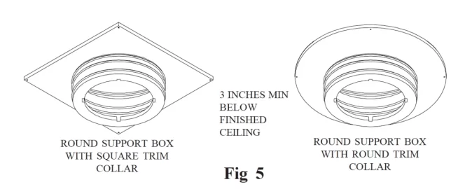

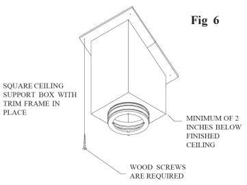

Would that be, "at 18 inches from ceiling, it must transition..."?
That would look pretty awful. 18" from side wall or from the top of a horiz. sw pipe. Most ceiling support boxes allow single-wall to be closer unless the ceiling is sloped and the side clearance comes into play.
