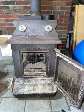

Hi all,
I recently purchased a house and it has a oil furnace as well as a wood stove in the basement. The stove is a All Nighter Little Moe. With oil being pricey, I would like to heat with wood this winter and thinking the stove should be sufficient for my ~850sq ft. I’ve never heated with wood before, but I’m excited by the opportunity to try it out.
The stove has a bunch of firebrick that is cracked/broken and I’m looking for advice on where best to buy new brick? I saw Tractor Supply Co. has seemingly decent fire bricks for $3.99 each, but have no clue of that is too expensive or reasonable? Also wondering where a good place to get fire rope to re-do the door seal?
I’ve read the Little Moe stoves are not very efficient and I’m considering getting a power blower for it. Does anyone have recommendations on where to find an adequate blower?
Thanks you for any help.

It's not efficient by today's standards. A baffle would help a bit, so would adding a generic blower.

I would say your brick is not the worst yet. Id just run with it as is, the little moes are the absolute worst to get old brick out of. And be careful of the asbestos mat under the bricks on the bottom.
As far as blower, I recommend This one to people who call the shop and ask about finding one, its not perfect but it works well. Just need to get a hose for it.
