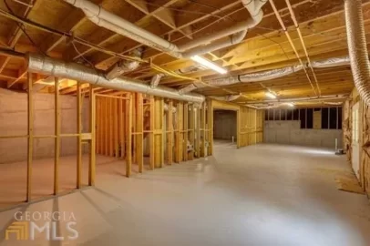

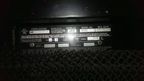

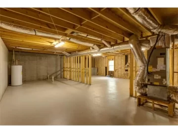

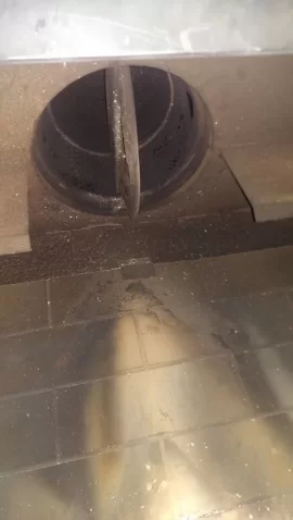

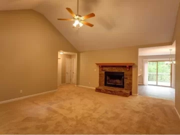

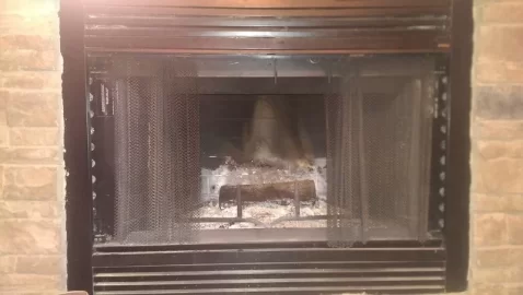

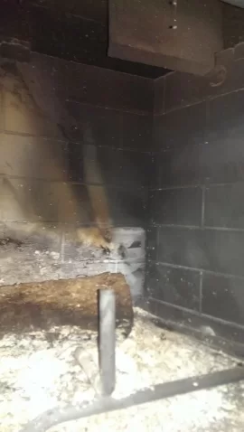

Below are some pics of my fireplace (Heatilator insert) as well as my basement. These are pics I already had, but I can take some more when I get home:

I was planning on putting the wood heater in the basement maybe from where this photo was taken. Towards the center of the photo you can see the air intakes for the central heat. If I got a gas heater in the basement, I would probably put it on the wall next to the air intakes. Right above the large doorway is near where the fireplace is.

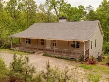

EDIT: Here's the exterior of the house and the chimney

I see, thanks for the pics - Unfortunately nothing looks easy
Fireplace - Zero clearance unit - bare bones builders minimum, in order to do anything a total rip out is needed, The metal chimney would also probably need to be replaced with an all fuel class 1 (rated for 2,100 deg) - that's a bummer
Down stairs also looks pretty bleak - a free standing unit would need its own class 1 chimney, there seems to be no direct route for the heat to go being that your stairway is tucked into the back of the room that's semi framed with its own walls (lots of blocking of flow)
Duct work in all there, since you would need a chimney anyway perhaps a wood furnace that can attach to the existing duct work. Or maybe wing it with a large wood stove in the basement and hope for the best since you are in a warmer climate.
*natural gas furnace into the existing duct work is prob best solution if you have gas on the property

The bottom of the stairs are accessed by going through the large door frame into the other room. Here's a photo taken from he bottom of the stairs:[Hearth.com] First Winter in new home - Heating Solutions
Natural gas is not an option, I guess I should've been more specific on that point. If I went the gas route, it would be propane with a tank. I'm too rural for natural gas.
Its a tough sale because the chimney pipe is going to cost you figure $85.00 -$100.00 per 3ft section, plus the through the wall kit, plus the chimney anchoring brackets. Then the stove cost, btw - if your going to spend the money on the chimney then try to get a new stove, look at home depot's web site at Englander wood stoves, a nc-30 would do the trick for your setup. They go on sale periodically and there regular price is $899.99
