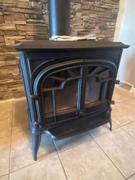

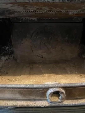

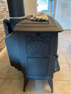

Thank you. We did look at PE super...could be a consideration but trying to narrow it down. The Nap. 1600 was well taken care of but as a newbie I'm not sure I feel qualified to know exactly what to look for on a used stove. We will probably stop to look at it. I attached the pics she sent.
[Hearth.com] First Wood Stove Recommendations Needed [Hearth.com] First Wood Stove Recommendations Needed [Hearth.com] First Wood Stove Recommendations Needed
Nothing glaring jumps out from those pictures. If the price is good, then it may be worth trying out.
