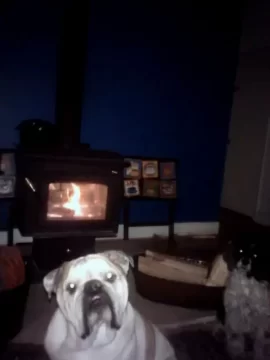

Your dog will probably fall in love with the stove like mine did. The hard part is getting them out of the way to load up or poke logs
