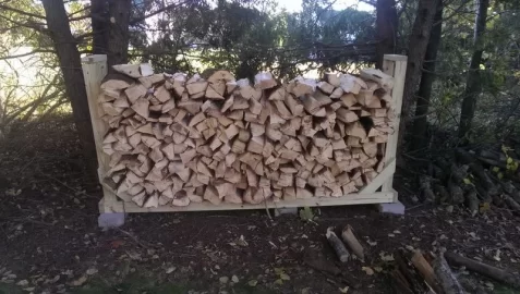

I decided to wait until next year to get a stove due to the challenge of getting good dry wood for the first year.
But taking your advice I got my first "free" wood split and stacked... Did I do it correctly?

Looks great now repeat 50 times.
You have 1 problem that I see, the location of your nicely built rack and nicely split wood is in a shady and probably damp location, I would move that rack to a place that gets sun and wind, otherwise I think you are doing a fine job......
You are off to a good start lostduck.
Ram 1500 is right about the location. I don't care as much about the sun but the windiest spot you have is the best. Sun is good but wind is the big key. As you go you will also be learning about the different types of wood. For example, the soft maple you have is a good wood and one of the fastest drying wood there is. We can cut, split and stack it and it will be ready to burn in as little as 6 months. It will give good heat and good coals but just won't give the longer fires that other wood will give. Still, we burn a lot of soft maple and love it. You no doubt have also learned it is one of the easiest woods there are for splitting. Makes excellent kindling wood too if you split some about 1" square. It catches fire fast and burns hot which will get the splits going quickly.
[quote="Ram 1500 with an axe..., post: 1555699, member: 27427" in a shady and probably damp location, [/quote]
You just described every location on my property. It can be overcome with top cover and time. And not freaking out when the mushrooms grow out of the ends of the splits. <>
You just described every location on my property. It can be overcome with top cover and time. And not freaking out when the mushrooms grow out of the ends of the splits. <>[/quote]
Hell, that describes this place, too !!
It's a wonder how I get firewood dry in this forest retreat !!
Got to love our Virginia humidity!

Ha, well I will tell you, I had my stacks in the driveway in the wind and sun, I also had the same wood stacked on the other side of the driveway but in a shady area, just like the picture we are talking about, in September I tested both sides and I got two totally different readings, the side that got no sun, less wind and was hovered by evergreens was not drying out any where near the other side that received sun and wind constantly, I know Dennis puts the Sun second, but I am a firm believer that it does its job quite well especially in June July and August here in nj.....

Its a game of rock paper scissors (wind vs sun).... The pine trees are only one tree thick and they are there as a wind break. The ground is dry there and I have limbed up the trees to get more sun this summer. This area gets x2 the wind of the sunny spot (the day i stacked this wood it was blowing 20 knots through there). I will keep track of it and if i start seeing mold/rot i will move it :/

Looks great!
I think you need more practice splitting. What are you doing Saturday? :)
good looking wood, nice splits. Rack is off the ground and should get enough wind and sun. Just curious about your saw cuts, looks like the bar & chain was running away on you a bit.
