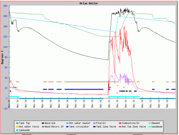

Below is a graph of my system for the last three days. Near the bottom you can see the system switching between 'wood mode' and 'tank mode'. My basic approach is to build hot fires and run flat out when necessary, and to use storage to space out fires for my convenience.

Love that graph. The "crazy up and down" when your boiler is running is exactly what I see. Very neat to see it in graph form...
