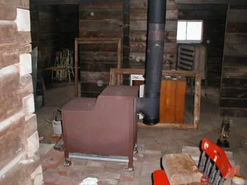

That picture is my own Mama Bear in my cabin that I used a Tee on the back. It gives a better fit, is stronger than an adjustable el, (you should be using a solid 90* elbow) and in cases where there is a very high ceiling, you can stack bricks or a non combustible support under the flat cap of a Tee. I use a Soot Eater chimney whip to clean from the top down, so I leave the dust settle after cleaning and remove cap with a bag under it to remove creosote. My stove is baffled so with an elbow I would have a much more difficult task getting the creosote out of the stove without taking the elbow off. I have no electric there for a vacuum.
