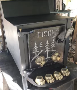

just wanted to share a picture of my latest papa bear restoration..:)..

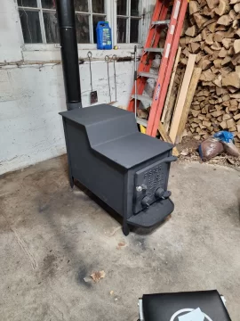

Just wondering if you can help me identify my newly acquired Fisher papa bear stove. I wrestled it out of my neighbors house and drug it across the lawn on my wife's lawn cart myself...what a beast of a stove! From what I have read it is an older model because of the solid metal knob and pipe cap air dampers. What I can find no information on nor photos of is a dial on the door under the letters "er" and between the fir trees. It has four holesand can be turned so that all 4 holes on the plate line up with holes in the door that appear to feed into some kind of diffuser plate on the back of the door...any idea on the age and this unique dial?

This is an added crude secondary combustion air intake. Not factory, as well as the welded handles on the pipe cap dampers.
The upper intake mixes air with smoke particles in the hope they will combust above the fire reducing smoke and creosote formation.
Without a glass door, this will be trial and error. About 500f stove top is the time to open it, and watch smoke.

Thanks much. I love my stove and it is fun that it has such a storied history. Any clue as to the year of manufacture?

If it was from Minnesota, 1975.
The first year ‘74 was all Oregon and Canada.
The licensee for MN was Roy Smith and Loren Trachsel, from Minneapolis. They were not welders, hiring the fabricator Self Suffiency which became Sierra Stove.

Very much appreciate and respect your knowledge....most likely from MN as that is where I am. It is in great shape and should last my lifetime! I will do some research. Refinished with my Viking fan on it.
