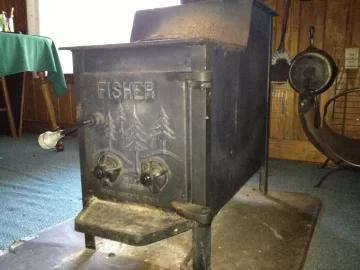

Nice forum. I am looking at buying my first stove. Found a Papa bear similar to the one Coaly posted a picture of on this thread but with a few differences. I was wandering why the door is a lighter color? The stove I am looking at has the same door but without the second 90 degree bend in the handle and has ball feet. I copied the picture Coaly posted below. Thanks for any information.

Just the way the light hit it. That's Stove Bright Satin Black. The texture of the cast iron door compared to the sheet steel stove reflects light different.
Here's the same stove stamped ser. #DBP198NY top left rear burning outside for final paint cure.
[Hearth.com] FISHER Papa, Mama, and Baby Bear Details (Bear Series)
The one you're looking at is a bit older.

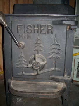

I've been checking several threads here to try to date my Fisher Baby Bear with a flat top 3 tree door, 3-1/4" diameter aluminum draft cap with fins extending beyond the OD, and "PATENTED D 237798" cast on the door. I've found no other markings on the bottom or the back of this stove. From other posts I am guessing it is between 1975 and 1979, but was wondering if the door and draft cap can narrow down the date.
My guess is earlier than later (pre '78) since it has the first style spring, straight handle and early draft cap.

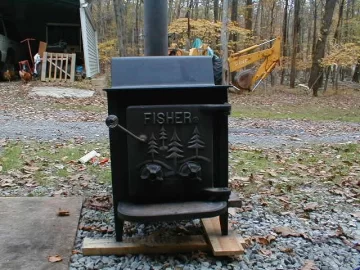

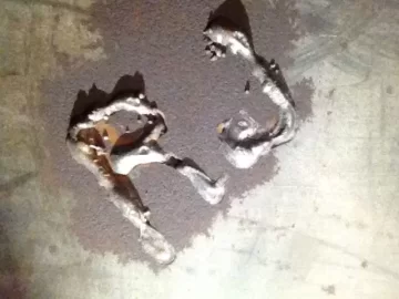

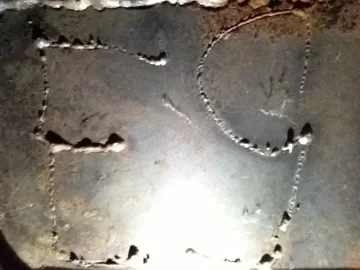

So I read all I could on the forums yesterday and impressed the pants off of my husband last night about our Fisher Mama Bear. We want to relocate the stove into our new home and have been asked by the county permit office to provide manufacturer specs and a UL listing. From all the info I gleaned on this website, I believe we have a 1973 Mama Bear, pre-UL with no printed specs available. Notice the four trees on the front and the Pat No D237798 Patents Pending. I did find a few welding marks under the body and ash tray. Can anyone confirm the year and provide assistance on how to convince the county to let us use this beautiful antique to heat our home? Many Thanks!

Mama didn't exist until 74, patent date on door was after nov. 75......... could be 76 or 77. Spring handle and draft caps changed after that. Installation depends on what country and state you're in. NFPA 211 has standards for unlisted stoves that would be used, as long as you're in a state that doesn't require EPA Certified stoves.
Looks like stove #53 ? Is the RJ (welders initials) under the ash fender? The state it came from if in the US may help.
The RJ is about 3 inches tall under the belly of the stove and the 53(?) takes up the entire ash pan. The stove is in Florida but family recalls it being purchased out of Georgia. Where would the UL be if it was on a stove? Thanks!

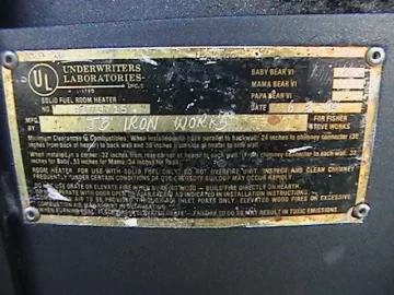

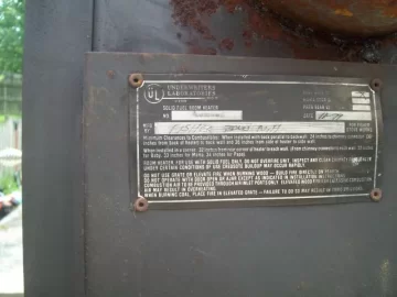

Bottom and rear shields were later added that the UL tag was attached to on the back.
Below are some examples;
[Hearth.com] FISHER Papa, Mama, and Baby Bear Details (Bear Series) [Hearth.com] FISHER Papa, Mama, and Baby Bear Details (Bear Series)
Yours should be installed by the unlisted default specs (known as generic clearances) given in NFPA 211. 36" to combustibles, 66% clearance reducion allowable with approved radiation shield...... single wall connector pipe clearance 18", double wall connector pipe for reduced 6" clearance to combustible. Heat shield specs are given in Standard as well. This is a Standard, from testing. Not a code, which local codes are written from. The standard used (normally NFPA standards are accepted nationwide) should be specified in your local code.
RJ probably built your entire stove that early. During the summer, during the slow season they would make boxes only without hanging doors and cutting vent. This way they could be made top, side or rear vent as needed when sold. The person hanging the door (welding door hinges in proper place) and cutting the vent / welding outlet pipe initialed the stove bottom. Common with Georgia stoves, not sure if any other fabricator did this on a routine basis.
Camfan may be able to tell you the builders name.

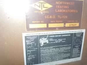

UL isn't a code. It is a testing facility that tests appliances and determines how they are to be used and installed. That is where the clearances from combustables comes from. Not the manufacturer. They check for sharp objects, edges, and temperature of stoves parts to keep within maximum safe guidlines. (among many other safety tests) Your stove was tested by one of many independant testing labs of the time. Since the stove was invented in Oregon, western labs were first used. Other states didn't recognize other labs across the country, so testing was done at many different labs for the area of the country they were being sold in. As so many stoves were coming into use, Bob Fisher pioneered this testing, sending and taking his stoves across the country to different testing facilities. Insurance companies and government finally decided on a standard testing facility, Underwriter Labs. That is why they ask for it's UL listing. It's not that the stove isn't safe. It costs about $20,000 to get a product "listed for use" today. Changing fuel (coal use) or certifying a stove for mobile home use is a seperate listing. Each model must pass it's own testing. The owners manual and installation instructions become part of the listed product as well. That is why they ask you for the paperwork. The testing lab gives the applicant the installation specs and makes sure it is correct in the literature supplied with the product. That is why most heating appliances today (gas logs and stoves) have a metal card on a chain with installation instructons on it. It can't get lost and the appliance is not supposed to be sold or used without it.
Here's an example of a Northwest tag that was the first testing lab used for the area they were sold in.
Codes are simply laws written "adopting by referance" of a specific standard or requiring certain "listing" facilities. If your local code requires installation as per NFPA 211, you may have to ask the code official if they allow the section of the code that gives unlisted appliance installation. Some local governments, or entire states, may add "UL listed appliance only" or "EPA certified appliance only"........ If they adopt 211 in its entirety, they should allow the section for unlisted stoves.
They just like clearance measurements on the stove so they don't have to think. >>
