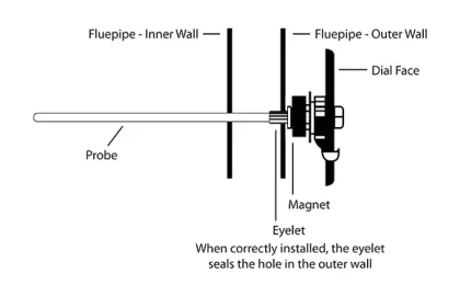

Single wall pipe using a magnetic surface temperature reading will be approx. 1/2 the inner flue gas temp.
Double wall pipe requires a probe inside for true flue gas temp.
So measuring temperature where it dumps into chimney, you can only guess the temperature drop you will have at the top without an IR thermometer measuring the temperature of the inner flue. The stove outlet should be the same size (diameter) as connector pipe as well as flue all the way up. When connecting to a larger flue, you will find a huge temperature drop where gasses expand and cool. So the chimney size, type (masonry or insulated steel) and interior or exterior chimney has to be considered for heat loss and what is needed to the top.
[Hearth.com] Fisher Stove/stove pipe temp gauge
So it must be no big thing to drill through double wall?
Sent from my LG-H811 using Tapatalk
No, its very easy, start with a small pilot drill bit, then drill the pilot hole to the size you need with a larger drill bit.
The instructions with thermometer gives the exact size of holes too. They need to be correct to avoid leakage around the outer hole that affects the temperature reading.
