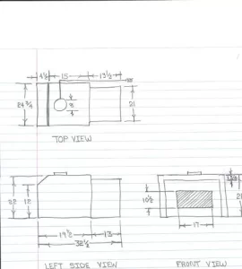

40 inches deep must be an Insert.
Pictures will identify it .
Here are the dimensions of the "Fisher Fireplace Insert". Adding the ash fender (ash shelf) at the front may bring it to your depth dimension approx 40 deep?
Some good pictures are needed to give you a build time frame. There were changes made through the years to all models. Door style, intake dampers, door springs , handle shapes all determine year of production.
