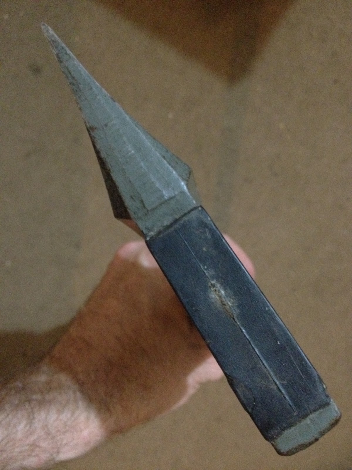

Looking at the axe heads from the top - the wedge of the blade on a splitter is much beefier than on a chopper. Much like the difference between the head on a maul and on an axe.
here's a pic of the splitter's head...compare it to your chopper

Get an X27 in your hands. You will notice the difference.
More weight (4.09 lbs) and a longer handle (36") on the X27 allows you to generate more splitting power. It's more like swinging a handle with a splitting wedge on the end instead of an axe head.
Just keep your feet apart for safety. ;)
