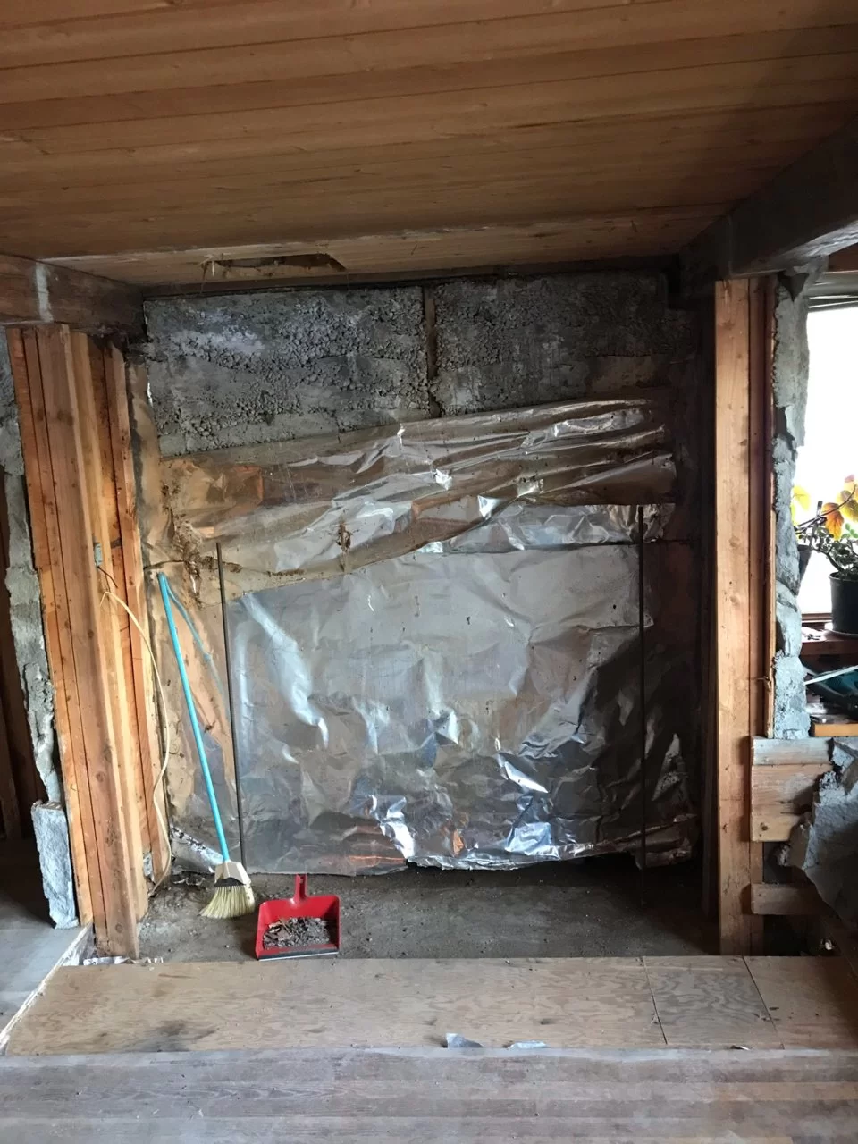

Now that I'm into the demo, I'm considering pouring an insulated slab to sit the Monaco on and topping off the slab with stone for the hearth. The Majestic I removed was sitting on a slab that was poured 7" below the finished floor. Each corner of the Majestic was sitting on three bricks to bring it up to floor level.

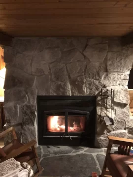

I’m finally getting around to posting a picture of how this turned out. All the clearances are met and we had no issues with the inspector. We’ve been really happy with it. More burn time would be nice but it produces a ton of heat and a beautiful fire.

That looks fantastic. Nicely done.
