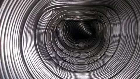

so basically my problem is that about 1ft above the woodstove there is a 2inch deep dent in my flex liner. The inside isn't damaged because I can stick my hand up there and feel that it is smooth and nothing is punctured. However, I'm wondering if I should try to pop the dent out of the liner, leave it as is, or cut the liner above the dent and connect a new piece of flex liner using a connector (I have a few feet of liner left over from the install). What would you do in this situation?
Also, just to clarify - the liner isn't crunched or anything - that dent is the only damage there is.

Yes, you can carefully try to bang out the dent from the inside. Just don't get aggressive and don't worry if it doesn't return to perfectly round.
here is a look from the inside

I would cut that section off personally. But Iwould not put the splice at the bottom.
At the top where it will see less heat.

it will weaken it some yes. Will it be enough to hurt anything? I don't know probably not but I would not chance it on a customer's house
