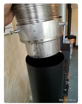

I have a simple question, can I fit the flexible liner directly on the stove (with an adapter)? It is a double-walled flexible pipe.
I’ve attached a picture I found on the web. Essentially I’d like to know if I can put that connector directly on the stove? So not putting the black pipe in between.
I’m putting a stove in an existing fireplace and it is pretty tight (picture also attached) and it would be really challenging to put in the black pipe.

The liner adapter can connect directly to the stove. It should be a snug fit into the stove's flue collar.
I'm not a fan of the adapter shown. It looks like it will pinch in the liner instead of leaving it round and tight like a band clamp would.

Thanks!
It will be quite easy to connect the flexible to the stove, if I need to use those black pipes it will be quite hard to do with several short bends.
This is not the exact adapter btw (I have not ordered it yet). But thanks for the tip! I will keep it in mind when I’ll order.
If it makes the install easier, these adapters also come in 15º and 30º angles.

But is there any particular reason why I would do that instead of connecting the flexible directly to the stove?
The flex is not smooth for one thing and will not seal correctly, the appliance adapters are created for that reason, the band clamp attaches the flex and the smooth end so it seals against the exhaust on the stove. Most will install L brackets to hold the appliance connector to the stove.

It will still need a straight appliance adapter in order to secure the flex but that will be under tension. Using a 30º flex adapter will let the flex follow its natural curve into the elbow without putting tension on the stove top connection. Direct connecting the flex to the stove would mean puncturing the thin flex with screws. That's not a good idea.

I think I misunderstood, I thought the 30 degree part was just the black pipe with 30 degrees. They sell those over here. I’ve attached a picture.
But I now realize the 30 degree part in your picture is a flex adapter by itself.
So when I said “connecting the flexible directly to the stove” I meant the straight adapter directly to to the stove. Or putting a 30 degree black pipe in between the stove and the straight adapter.

It's probably dependent on your install . Both my stoves use flex directly to an adapter like bg's above. For me, as it sounds like for you, that was the best solution without putting tension on the liner etc . I think that's what these posts are saying but it's a bit confusing. You just need some sort of adapter between the flex and stove collar

A stainless one, yes. The black pipe you pictured is steel, here in the US that can't go in a fireplace on an insert stove, it has to be stainless...and since you are using a flex liner, the 30* liner/stove adapter would be what you'd need...the only other option that comes to mind would be the straight liner adapter (that you said you can get readily) and a stainless steel version of that black elbow that you have pictured...that would work too, if you have the room/height to make it fit
