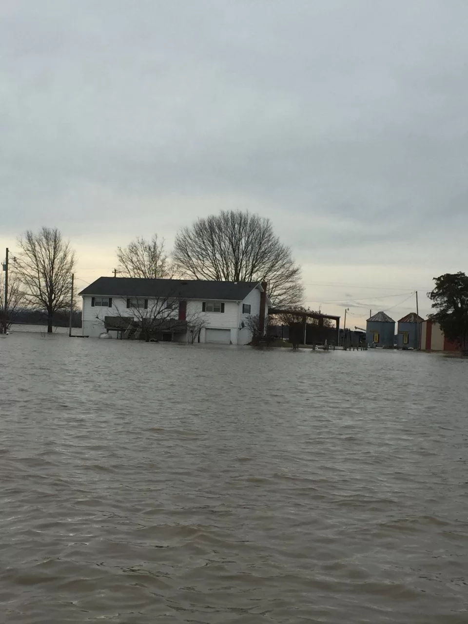

We live in the Mississippi River floodplain, and if anyone is following news of the Ohio/Mississippi river valley, the water is rising. We are looking at a crest that will have water 4-6 ft deep in my yard. All forklifts in the area are already busy or hauled out. We have decided to leave it in place, and remove all electrics from it once the water is touching the base. Before that point it'll be running. Earth says it should be alright, but I'm curious has anyone here experienced flooding, and if so, how well did the insulation hold up, did you have to rework anything??

Floods gone, for the most part. At crest water was 2 feet deep above the pad. We pulled the furnace. Original predictions would have put it almost exactly 6 feet deep over the pad. My neighbor still had his tractor with improvised forklift mast on the three point. He tossed it on the goose neck for me last minute. The last load we hauled out we drove through water a foot deep getting out. When water is approximately 3" deep in the basement (technically the ground floor so as to elevate the living space above the 100 year flood record.) it is too deep to evacuate any more due to the lowest water crossing being about 3 feet deep with a very strong current.. My little abode here in the river valley is subject to irregular flooding. 2011 had 10' of water in the yard. 2008 was very similar to this one with about 1.5' of water. While I'm aware that most electric equipment will survive some flooding' it's different when the flood stays for several days or even weeks. The electrics didn't concern me because i was going to pull those off anyway. My main concern was insulation degradation. As far as driving in it, we drive through with the deepest crossing pushing water inside the doors of my 1ton diesel. At crest the lowest crossing before our house was about 5 feet deep. We have been driving through water since Sunday with Sunday being about 3 feet deep.It has dropped since then. As of tonight with the lowest point before my house being a couple inches deep. My speedometer still is not acting right, The regulator is also intermittently overcharging and the interior lights won't cutoff. If it were a gas burner instead of an old mechanical IDI engine I'm sure it would have more issues as the current and truck motion can sometimes force water over the hood when it is actually only three feet deep. If we would stop in the current the upstream side would pile up high enough to touch the mirror brackets. But it's home we knew about water before we bought the place, and while backwater makes things much less convenient, as for several days the only was to town included 30 minutes to an hour in the a boat. We only left for two nights because our boat isn't big enough to safely hual all the kids to meet the school bus on high ground.
