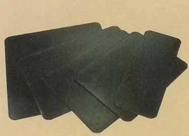

Yes, there are UL rated stoveboards that are 16 or 18" by 48" that should do the job. You should slightly overlap your existing hearth with it, and fasten it so it cannot be kicked out of the way easily (small screw and bracket - or silicone, which can be removed easily)....
Example of thin hearth board.....

do you think you could paint these, so they were not black and does anyone know how thick/high they are? Wondering if they are going to pose a tripping hazard...........
Looking for something cheap, safe and looks good. It will be on a hard wood floor.

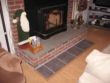

I had the same problem with less than 18" in front and put in a row of tiles.I thought about a fire resistant hearth rug but heard its a no no!so i thought i would do it right.My dad is getting a insert installed soon and will have the same problem!I guess he will have a tile job for me soon.
NOTE! Items near stove moved when stove is in use.

that is almost exactly how my setup looks! Did you have to put anything under the tile for additional R factor, or just as is. My hearth is 14 inches up, looking about your same distance from floor and I am 8 inches short on the front end. Those tiles look to be 12", correct??? Wood trim around the edges? Thanks!

Yes! These tiles are heavy duty ceramic 12*12 tiles.!I had to do some patchwork before the tiles went down.Just used tile adhesive spread thick and tiles on top with the grout in the spaces.The trim i used is T trim which snaps into a channel placed on the floor.Note! The trim isn't cheap!! ran me about $18 for around a 4ft piece.
