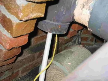

Once I had the setup, I pulled the cap off the bottom of the stove "T" and stuffed the brush up the pipe. Getting the brush started was probably the hardest part, It was very difficult to flex the conduit enough to get the brush going straight up the pipe, plus I got a little bit of a hangup getting the brush through the "T" - After that, things went reasonably smoothly, I got a LOT of crud out, about half filled my ash bucket, so I'm guessing about 2-3 gallons, all the black crunchy stuff, mostly in fairly large chunks.

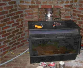

Photos--- First is a front view of the stove while cleaning is in process - assorted tools on the stove top, the rod is going in behind the stove from the left side.
  • [Hearth.com] Flue brush and rods - where to get?

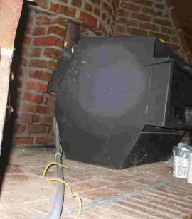

More photos - this is a closeup of the space I had to get into - the round thing on the bottom is the stove blower, the rest are the bricks on the back wall and hearth.
This is a shot of the rod going up from further back, I have about 6 feet of rod up the chimney right now, and have just attached the second section of conduit.

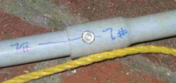

This is a closeup of one of the conduit joints. Since I drilled them freehand, I put an index line on each joint, and numbered which ends went together so it would be easier to get the bolts in when putting the sections together.

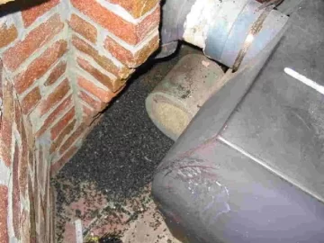

This is the pile of crud that I got viewed from the top...

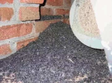

And the same pile of crud from the side...
