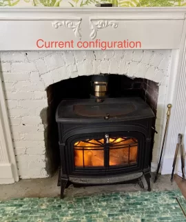

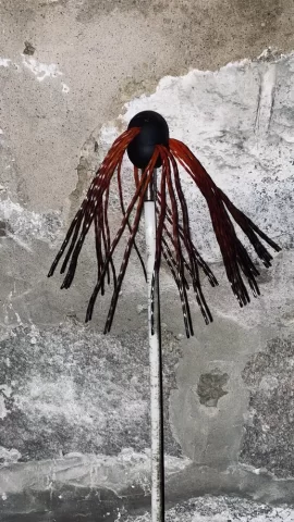

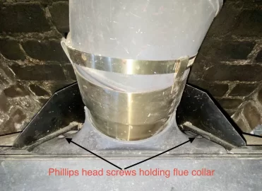

Hi, I have a Vermont Castings Encore Wood stove purchased in the spring of 2021. I have burned 1.5 to 2 chords of seasoned hard wood. I would like to clean the flue for the first time this fall. The stove is placed in a fireplace and is vented up the chimney with a 5.5 inch diameter stainless steel liner. The chimney is approximately 23 feet tall. Due to the slate roof, I need to clean the flue from the stove up. Here is my plan. Detach the rear heat shield to gain access to the flue collar. Detach the flue collar. Pull the detached stove forward 2 feet. Insert Xedragony Chimney Cleaning Brush Fireplace Flue Sweep Whip Cleaner and go to work. I have used the Chimney cleaning brush on a fireplace chimney with satisfactory results.
The stove works wonderfully. The draft in the chimney is terrific. I’m hesitant to go forward because I’m afraid of screwing up. I am not looking forward to detaching the flue collar and moving the stove, but I see no alternative. Going through the stove’s open damper is not an option as far as I can tell.
I do plan on cleaning the catalytic combustor at the same time. I’m attaching several pictures with captions. You can see that the placement of the stove so close to the chimney necessitates that I move the stove forward to get access to the flue.
Thanks to all in advance for your help.

Why not just clean through the bypass?
Sorry ....where is the "bypass"?
The bypass damper at the top of the firebox in the back. It opens right in front of the flue outlet
Thanks. I can't get a brush up there, the opening is too small and the curvature of the connecting to the flue is too much of a right angle for the bend flexibility of my rods.
I can’t offer real technical advice, but maybe take one of the Rod sections and test out how flexible it really is. It may break but then you’d know how much you can bend them. Are they Sooteater brand?
If that’s a no-go, maybe there are more flexible rods out there.. I say that bc as @bholler mentioned, there may be an easier way to clean the flue. It would stink to have to do it the hard way year after year.
My sweeping process is easier but I still try to think of ways to make it more efficient. It’s a pain in the ass No matter what but I’d do whatever needed to make it easier.
I used to clean my VC Encore via the bypass door using Sooteater. It takes a bit of wiggle and patience but the head of the Sooteater will go through. I know more people here with these stoves clean the pipes this way. Thanks @bholler 😉.

Thanks all! I am going to try the SootEater Rotary Chimney Liner Cleaning System. It is indeed more flexible and comes with a considerably smaller cleaning head and thinner rods. Thank you, I would not have found that on my own. I imagine I will remove the fallen creosote at the base of the flue with a vacuum seeing as there is no room to get any type of tool or utensil in there.

When I sweep my Encore I remove the lower fireback and refractory and clean the combustor. I then can easily access the chimney with sooteater at the same time
