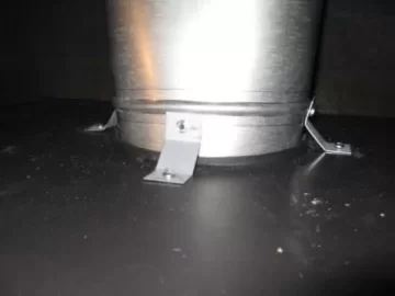

I got my insert from a dealer and it did not come with the adapter. I ordered my 5.5" liner on-line and it came with the adapter to connect to the stove. Not sure how other liners connect but this one does use 3 straps. It is solid and not going anywhere:
[Hearth.com] Flue collar adaptor for Hampton/Regency?
The screws that came with the stove did not grip in the holes tight and easily stripped. So I used some self-tapping hex head sheet metal screws and a driver in a cordless drill.
