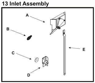

Ah, thanks, that helps. The AU docs for this stove are just for installation. They don't include the operation and parts diagrams. My docs for this stove in the US are from 2010. Is the air control still set up like this? If so, I am unfamiliar with the boost air location.
TomMcDonald
Feeling the Heat
Nov 18, 2022
361
Australia
Although I haven't opened up the side shield that hides the air control, this looks like the same setup.
I am led to believe that the rod E closes the boost air (D and C) once the lever is set to half way and below.
Part A is the lever and the control for the air wash.

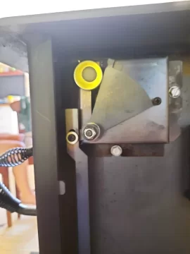

So the thing went thermo nuclear again this morning even after turning down to full closed very early. Was getting stove top temperatures of 850f.
I decided to expose the intake to have a look and see what's going on.
As per my understanding, the boost air is fully closed with a plug at half air setting and below so that's already blocked.
The air wash is left partially open even at the lowest setting as expected.
I found a magnet and placed it partially over the aperture. Will have a chance to test later.
Does anyone see an issue with partially blocking the air to control the burn early on? Apart from the possibility of increased emissions?
If successful I'd look at shaping a magnet to fit more closely and finely tune the opening.
Thanks again.
EatenByLimestone
Moderator
Staff member
If thats what you have to do to control the air, that's what you have to do!
Reactions: TomMcDonald

I was just going to suggest a top down fire. I have found that adjusting the amount of kindling and the size of the splits under it can have an effect on. Urn rate. I’d probably install a damper. I messed with trying to restrict primary air but it never balanced with the secondary. You might have better luck.

Am I right in thinking the damper will theoretically slow down air coming in due to slowing down gases going out?
Thanks.
begreen
Mooderator
Staff member
Nov 18, 2005
100,910
South Puget Sound, WA
Yes, the damper will reduce the strength of the draught (vacuum) pulling air through the stove.
