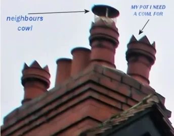

I'm in the UK and I'm going to be using 904/904 6" flue liner. I'm hoping to find a cowl that fixes to the liner so I don't need to take the pot off. I can't see any pictures of a cowl on a leeds bishop chimney pot on the internet, though there are plenty of nice terracotta coloured ones around, I dunno if they're suitable for my pot? Obviously I see the neighbours cowl, but I find it a bit uninspiring and detail matters to me :0)

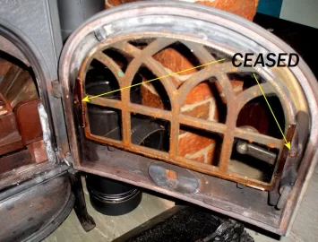

Also, I am currently refurbishing a jotul f3 td with multi fuel conversion grate. I cannot get the two screws loosened on the door glass clips for love nor money. I'm worried about drilling them out and ruining the threads in the cast door, as a new door will cost £150.00 plus. Any ideas? I've soaked them in WD but they seem to be ceased.
