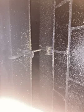

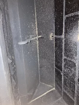

Hi, I’m trying to understand what happens with install with existing flue? Meaning does the flue get removed and the 6” line get put in for an insert but wouldn’t there be cold around around stove then. I’m sure there is a remedy I’m just a novice when it comes to stoves and inserts. Enclosed are photos of my flue opened and closed in existing fireplace before insert install. Looking at Kuma cascade, Montlake 230, regency 2500. I’ve heard good things about PE but with no credit I feel like not worth it.

After the chimney and smoke shelf have been thoroughly cleaned the insulated liner is installed. If it fits, nothing is done to the chimney's existing tile liner. The damper may need to be notched or removed to clear the liner. If the insulated liner doesn't fit well due to a narrow chimney tile, then the tile liner either needs to be ovalized or removed.

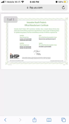

The Montlake 230 also does not qualify for the tax credit. The only non-cat that does is the Lopi Evergreen insert. You might also want to consider a Blaze King insert.

Thanks for the response regarding the liner. The installer had stated based on models I was looking at and my chimney height (16feet) I wouldn’t need double walled liner, whereas blaze king does require it. I believe he said just a stainless steel liner. Not sure if that is the S.O.P.. also trying to understand your comment the opening in flue when opened is about 6 inches by 15 inches so wouldn’t there be a gap where cold air can make contact with insert and stove. Lastly see photo I got from Montlake website.

Code dictates whether a liner needs to be insulated, not chimney height. An interior chimney needs to have 2" clearance from any and ll combustibles, all the way up. An exterior chimney needs 1" separation. If the chimney does not have this clearance then an insulated liner is required. An insulated liner provides greater safety and performance, particularly for catalytic stoves.
To top of the chimney gets capped but the best thing to keep the fireplace area around the insert warmer is an insulated block-off plate sealing the damper area. This can make a notable heating improvement with exterior wall fireplace installations. This costs extra, but the performance gain is usually worth it.

AFAIK, the Montlake 230 does not qualify for the EPA tax credit.
