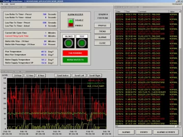

What a difference a cleaning makes. Flue temps down almost 200 Deg! The trend to the right is last night's firing cycles after my cleaning.

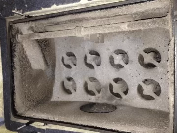

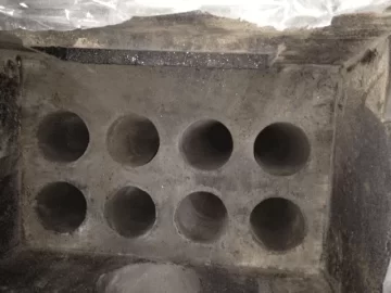

Before and after cleaning. That cleaning tool really works. There was a lot of crusty material beneath that ash. Takes about 20 seconds per tube. Bigger pain now is keeping the ash down as I push it down the tubes into the tunnel so I don't have ash in the air. When I disturb it and it falls the draft pulls it back up. Thinking about making plugs for each tube and an 'umbrella' for the cleaning tool I built for the tube I am cleaning at the time.
Wow tha'ts quite a diff. was it only fly ash in the tubes or was there creosote as well. I'll try the same test with my Vesta data logger in a few days usually only fly ash in my fire tubes . Was your'e fan speed the same in both graphs also?
Huffdawg, my fan speed is fixed on the Tarm. There was some crusty crud underneath the flyash, although not as much as I thought there would be. That tool will take anything off. Very aggressive. The heat transfer is unbelievably faster after the cleaning. That buildup was after 40 days of continuous firing. Normally clean after 30 days,
