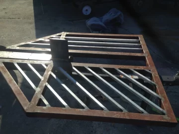

I have a speeco kinetic splitter and I love it! I bought off of craigslist for $700 and it had some custom work done to it. I used to think these splitters weren't worth it. I had trouble keeping up with a hydro splitter! The difference is that you aren't waiting on the slow travel from 24" down to 18" splits. There is a lot of wasted time with hydro splitters. I do agree with the statement above that if you don't have help then the kinetic splitter won't be a big time saver. It's still a time saver, just probably not worth the extra money for a new one. I was lucky to find a used one.
