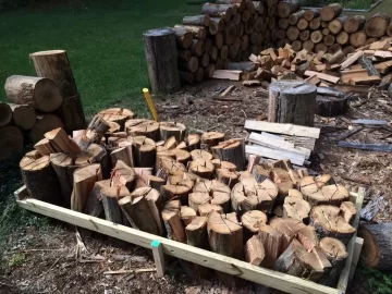

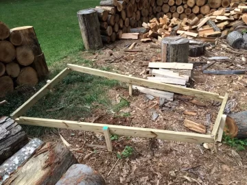

I know it looks rickety. But I sort of needs to not be too rigid to be able to absorb energy. Each corner is pinned. And there is a foot in the middle of each board. Those two thing allow it to move around and not break. The pins let the frame pivot and match the shape of what you put in. The feet in the middle allows the frame to teeter at the corners where it's more likely to take a blow from the maul.

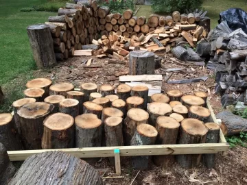

Basically fill it up. Not to full. So that the maul can displace the wood and have somewhere to go. Then I start swinging at each round in one direction. Making a fault across the diameter of every one. Then I stand on the other side of the frame a make a fault perpendicular to each round. So I end up quartering each round. Then any thing that is still to big can get swung at again.

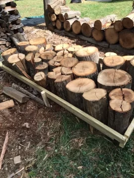

First make your fault on the diameter.

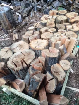

Then go perpendicular

My frame holds about 36 cubic feet of rounds. I did four frames in two hours. Approximately 1 cord stacked I believe. The two hours included unloading the frame. My work area wasn't set up very well. Ideally I'd have been able to lift the frame off the split wood. Move it over and load it up. I thing that had I done it that way you're looking at splitting a cord into medium size pieces in a little more than an hour.
