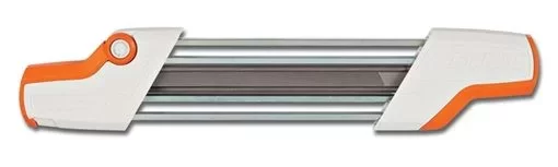

There is always this:
http://www.stihlusa.com/products/chain-saws/accessories/filing-tools/2in1file/
[Hearth.com] For crying out loud, there are TWO steps to sharpening a chain!!!!
Suppose to lower your depth gauges as you file.
