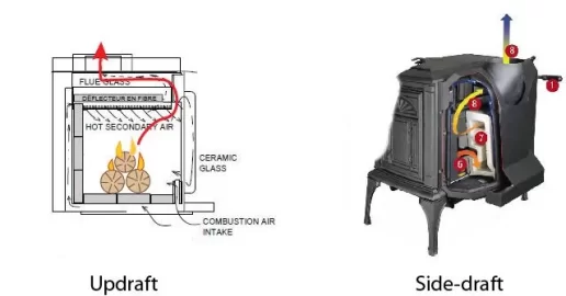

Most of what we are calling downdraft stoves are actually side-draft. In an updraft stove, the burning wood gases travel in an upward path toward the flue exit. There are several variations on this theme, but that is the core design. The Avalon Arbor and it's sister stove, the Lopi Leyden are side-draft stoves. So are the non-cat versions of Dutchwest and some Vermont Castings stoves. In this case, the flue gases go down or sideways into a secondary combustion chamber, before eventually heading upward toward the flue outlet. The flue design is more critical for proper functioning of these stoves. They need a strong draft to pull the gases through the secondary burn chamber(s). When the draft is perfect, they can be decent burners. When it isn't, they can sometimes be hard to manage. One frequent problem with them is puffback from shutting the fire down too early, less than adequate draft or poor wood. Another complaint has been about the rapid degradation of the refractory materials used in some of these stoves. Because of the circuitous smoke path and mixed materials, they are more complex stoves that have more parts and need closer attention to cleaning of this secondary smoke path to keep at peak operating efficiency.

On pages 4 & 5 they have a nice set of diagrams showing the smoke path in a Leyden.
OK, there seemed to be some confusion in the post by grouping the Alderlea with the Arbor. They are functionally very different stoves. The Harman Oakwood is a side-draft stove.

Right, and the downdraft drafts straight down through the coal bed.Needing a good bed of coals to do it's reburn job.

Yes, it is a smaller version of the downdraft/crossdraft Oakwood.
