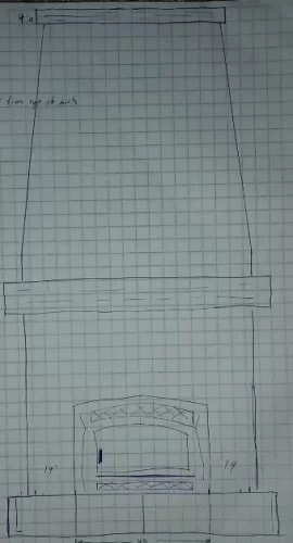

1) I prefer the hearth raised so that is a bit easier on the knees when loading. Plus it's nice to sit and warm your back, for a few seconds. Here is a scale drawing I drew for our install. each box is 4 inches. I forgot to take into account the hearthstone height of 1.5 inches. So like most building projects we had to build it about 10 inches so the hearthstone could sit on top then the arch surround flush on that.
