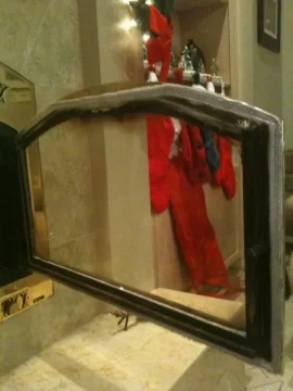

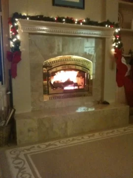

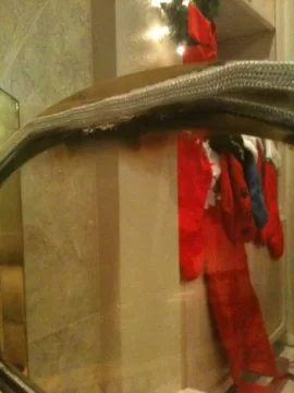

I'll post pix when I get home; but a CLEAN window is somewhat subjective, so I'll show you what mine looks like. It's kinda like when people talk about how long an overnight burn is, or how long between reloads, it all depends.
I have the 36 with a 12ft. stack and this is my 3rd year learning and running it (thanks again to everyone here). I buy/burn Almond which they say is 1+ yr. season'd so I take their word for it. The wood has the "checks" in it, so I think it's dry, never any hissing or moisture/vapor and when I cleaned the chimney this past fall, I barely had any flaking so I think I'm doing pretty good and being efficient.
I noticed the seal on my door was beginning to wear down and it was mostly from me trying to make the window all "pretty" when I cleaned the window. It would happen because I'd bump the seal up and off a little bit so then I'd press it back down to get it back in place. I think in the process of me pressing down, I was actually pushing too hard and compressing it past where it made a good contact with the frame causing more than necessary air to enter and having more issues with dirty glass. Even though I'd do the dollar bill test, it seemed fine, but usually dirtier than I would expect and last year I was cleaning the glass what seemed like 2-3 times a week. This year I kinda leave the edge of the seal alone and hardly clean that close to it at all, except maybe to brush some occasional ash from the window with just a dry hand towel, that's worked for me so I have only cleaned the glass once. If I do something to get the blackened window, then I use Easy-off and just wipe it right off. Uh, I never could get a hot fire to just burn off the black when I really goofed.
Also, here's my other burning tips that I've learned I do for the FPX. I took out the grate and just use the square andiron, I don't let the wood burn too close to the window if I can help it. My IR gun sez I'm cruising between 450-650 and I usually go ~ 3-4 hours between loads.

I don't have the same stove, but when I say my glass is clean, I mean it is crystal clear. My stove is rarely perfect like that after burning, but if I have been burning reasonably dry wood at a reasonably high temperature, I get minimal build-up. Like I said, it might take 30 seconds to wipe clean with a damp cloth. I'll use a spot of ceramic stove top cleaner on any spots where I get a little build up every now and then. I typically wipe clean my glass 1X per day, but I am a neat freak like that. You can even do it with the stove running if you open the door, let it cool down for a bit, and are careful.
