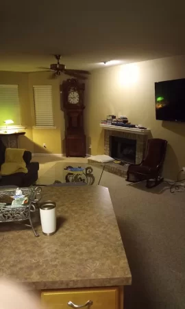

Help choose a ZC for 1300sq ft (two story) home
AuGold
Sep 24, 2023
5
Tennessee
I have been recommended a Pioneer ii by a reputable chimney company, have also looked at FP16 and Lopi Medium Flush to replace my current fireplace but am worried the room will be uncomfortably hot. I don't mind cracking window if necessary but wanted to run it by you guys for any thoughts or recommendations?
Has to be zeroclearance.
I want to stay on the smaller side, I am okay w burning smaller fires to limit heat output but I then worry the viewing glass will just become dirty from not burning hot enough.
Thanks!

Not sure you could put an insert in there. Is that a masonry fireplace or just a facade?
If masonry, Lopi medium could work but dimensions are needed.
If not masonry, then you’re looking at a ZC fireplace like a 36 Elite from FPX.

Do you know the make and model # of the current fireplace? There is often an ID tag on the door channel. A limited number of ZC fireplaces can accept an insert. If this is not possible, then a 1.5 to 2.0 cu ft ZC will work. The FP16 or Pioneer II would work. There are several others from Astria and RSF. When less heat is desired just burn a 3 log fire.

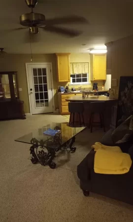

Tell us more about how this room is connected to the rest of the house so that we can understand how heat will move. Is the room closed off with a narrow doorway or open to the rest of the floor? How large is room, how many sq ft on this floor and in the house?
It is a Majestic MBU36.
I really like the RSF options but my chimney company isn't a dealer for them. I've had the Pioneer ii and FP16 floated as options. I'd say 700sqft main floor and 700sqft second story.
