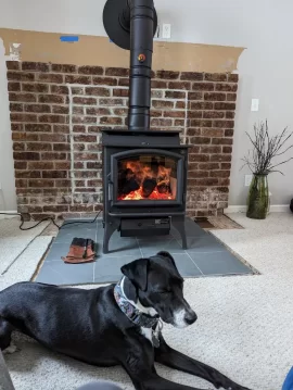

I just got the Lopi Endeavor installed last week and it's heating my 2200sq ft house nicely. The dog is also a big fan of the stove.
