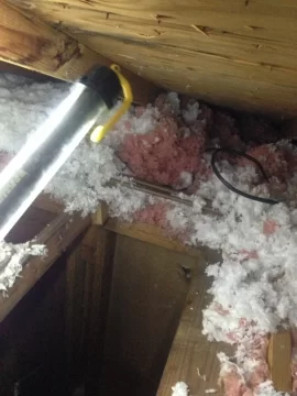

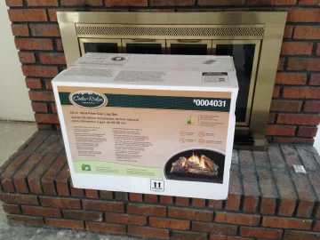

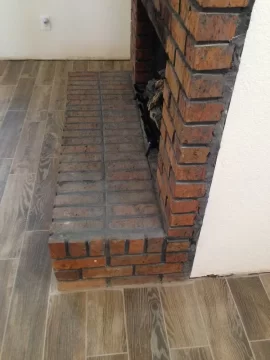

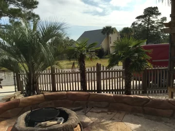

Here’s some pic’s, most prior to us moving in. A few of where my husband built a patio with “his” fireplace…pit, right in the front yard! He say’s it makes him feel like being back in Alaska, so.

Yes, this is a ZeroClearance fireplace. The insulation around the chimney and that has fallen on top of the stove is a red-flag, especially if it is blown-in cellulose. Based on what you are saying. it sounds like you would just like to tear it all out. That's fine as long as it isn't structural. There are not a lot of double-sided stoves sold in the US. Supreme is probably your best bet for freestanding or fireplace.

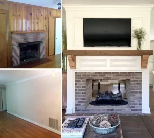

My husband would like to retain the current fireplace, maybe knock the walls out but leave a squared box area with the flue coming out the center, with a wood burning stove in the middle of the fireplace, like the first pic shows.

If I had the same requirements and preferences, I would be leaning toward double sided fireplace.
After a couple seasons living with wood feeding a wood stove I can tell you that the area around the fireplace and where the day’s wood is stored (or displayed) needs to be easily cleaned because it will shed bark, dust, splinters and other stuff that needs sweeping.
Also, The floor in front of each side needs to be not carpeted, preferably stone or tile because there will be a live coal popping out at one point.
Also also, it would be a good idea to have a good hearth slab. Something deep enough to catch most of the ash.
Of the pictures you attached, this one looks closest to what I would put in my southern home.
[Hearth.com] New member needing guidance...
While romatic and nice to look at, open double-sided fireplaces of that design are known to be big heat sucks out of the house and often are poor performers. If the goal is also to provide efficient heat then the enclosed design of the Supreme will be more efficient.
