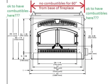

2. for our mantel, we plan to use our existing doug fir piece that we really like. we'll keep the 60" clear from bottom of fireplace to bottom of mantel. however, we're thinking that we'd like to use doug fir corbels instead of stone corbels. if these wood corbels are spaced such that they are not directly above the fireplace (i.e. draw lines up from the edge of the fireplace and make sure the corbels are not within the lines), does the 60" clear requirement still apply?
If you are going to use combustible corbeils under the mantle, they cannot be within the outer edges of the non-combustible boards supplied with your Northstar. They can abut the outermost dimension, but they cannot cover any of it.

i'm not sure what the outer edges of the non-combustible boards supplied with your Northstar are. is my attached sketch accurate?

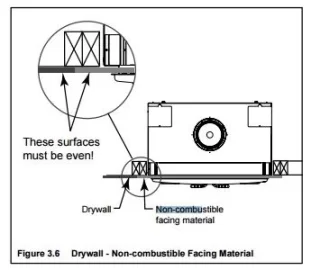

See page 55 of the manual - figure 10-2 for the non-combustible boards.
my manual (downloaded online from their site) goes only to page 44.
is it this image, from page 15?
  • [Hearth.com] framing requirements for heat n glo northstar
thanks bob.
so, comparing my image from page 15 of my manual vs. your excerpt on page 55 of your manual, it seems they are more or less the same. the image on page 15 seems to be more conservative (i.e. farther from the heat) than the page 55 side pieces, so as long as i'm outside of that, i should be good.

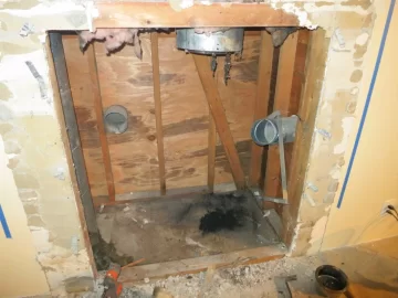

i just got done demoing the existing ZC fireplace. pain in the butt!
anyway, i see if have two existing 6" vents in the wall in the attached picture. do i need both of these for the OAK? or, will one suffice and can i abandon the other one? any thoughts on the best way to abandon the one? seems like i would want to cut it flush and seal with some spray foam to prevent outside air from hitting the drywall and insulation i plan to install tomorrow.
also, if i use one of these existing ducts for the OAK, which should it be?
lastly, will i have cold air intrusion with the OAK above my fireplace elevation?
thanks
Use the one on the right if you can.
That's the side that the OAK attaches to the Northstar.
How wide is the inside of that old chase?
Like I said, 6 FEET is the ideal opening it, regardless of what the manual says.
As far as repairing the rear hole, remove ALL of the ducting & the hood.
Make a plywood plug for the sheathing & attach to a cross brace.
You might want to add some plastic sheet to seal it against the elements,
inside & out. Matching the vinyl siding might be the tough part.
It will have fade from the sunlight.
