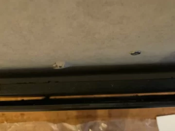

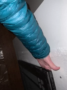

My contractor asked me what finish I planned to use with my Mendota FV gas insert and I said tile was most likely. The dealer mounted it protruding about 3/4 of an inch from the wall. I can fit my finger into this 3/4 inch space behind the front. I was told thi s is fixed — it can’t be adjusted. This is too much space for tile which should not I think be pushed behind the face of the unit anyway—limited info online says it should be mounted flush so that tile can abut the side of the front frame. I would be fine with just finishing the nonflammable wall material — mudding and paint would be my first choice now. I did ask my countertop installer about stone and they said the distance would need to be adjusted in that case too. I think my best option is to use appropriate nonflammable material and build out the wall to meet the insert. I don’t have an installation manual and can’t find one online. Is there a way for me to get a copy of the installation manual? Did my contractor or dealer make a mistake. Do I have to pay to build out my wall or should my contractor or dealer be responsible?

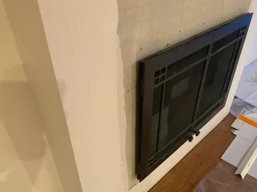

What stage of construction are you in here? Is there board up yet? Can you post some pics. I don't like mud and paint regardless of if you use high temp paint I see so many start to crack above the fireplace like this.

Sorry this is a Mendota Full View fireplace. This first picture is looking down on the fireplace. There is 3/4” between the wall and the frame and the brown line showing the floor beneath is the space between the doors and the frame with the window. The last shows my fingers fitting in behind the frame of the fireplace—this is the 3/4” space. Should it be installed 3/4” proud so to speak of the nonflammable wall material behind it? I thought that it should be installed flat to the wall for tile which would then abut against the side of the frame. Or, my preferred choice, looking like it is just mounted on the wall — perhaps just mudding and painting?

Yes it is. Thank you! It is from 8 years ago, so I don’t know if the model has remained the same. But I can’t figure out from this if they should have mounted the fireplace as they did. That is sticking out 3/4”. Looking at p 13, I don’t think they should have done this, but I am not sure that it is prohibited to do this? I have never installed a fireplace, and am not sure exactly what I should be looking for here. What is it reasonable for me to have expected an installer to do?
I think daksy can answer this better than me, I focus more on service work. But I think your installer has the concept of and insert and zc fireplace mixed up. All the zc fireplaces I work on are installed butting up or sometimes overlapping with the frame of the fireplace (not interfering with glass removal or access panel some have.) insert on the other hand slide back into a masonry fireplace . In some installations customers have their masonry fire place refaced. In that application you would tile behind the backer plate of the insert. I would ask your builder or fireplace company to explain their install a little more and how exactly they plan to make it look how you want. If you just Google image search this model you will see they all look like how you expect them to.
