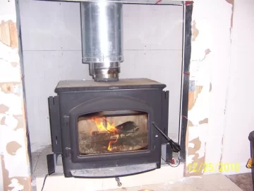

We are getting ready to remove our small insert and replace it with a VC Defiant. The insert was installed two years ago. I completely pulled out the zero clearance fireplace and used a 6" SS liner to a Napoleon 1100 insert into the hole left from the fireplace after building a cheap hearth. Although I feel safe with this setup I realize that it is not up to code. I have searched and cannot find a definitive answer.
Can I run my new free standing stove with my existing chimney set up??? Or do I have to change every thing out to single/double wall pipe and new class A chimney???
It would seem to me that if an insert is approved for use with ZC chimney with an insert, then a free standing stove should be approved as well. Please advice.
