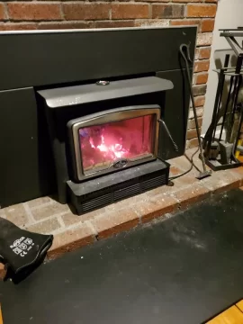

My insert protrudes about 8" and does OK during outages if the temps aren't crazy cold. It'll keep the stove room warm and upstairs sleepable. The rest of the house will be very cold though without the blower. In fact in prolonged outages we run the generator to plug in the blower along with the well and fridges.
So while it's certainly better than a flush mount insert, it's no freestander. I only went this route because I had to. My house isn't very big and we have a perfectly good masonry chimney so we didn't want to sacrifice more space. If I were building a new home I would 100% go freestanding tube stove and make it the centerpiece of a room.

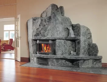

If you want a big pile of stone to look pretty and warm up the house, new construction is a rare opportunity to have a real, centrally located masonry heater.
They're not common or cheap but they can be excellent heaters. A new install is best done by building the heater and then building the house around it.
There are quite a few good threads on here. (Try doing a Google image search for "Tulikivi" too!)
