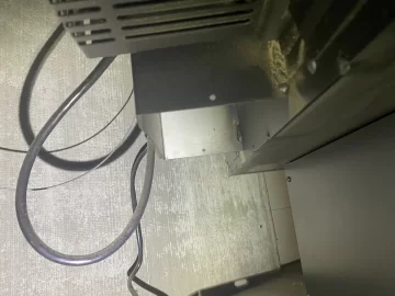

Turns out, the adapter does not seem to fit the stove very well. They don't look like they were made for each other. Yes, they are both roughly 4 inches by 7 5/8 inches, but they just don't fit together well. For one thing, the adapter looks like it's designed to wrap around, on four sides, something that is box shaped, but the stove fresh air opening (see attached photo) is not shaped like a protruding box. The adapter is just a little too big to fit inside this rectangular hole, unless I try to bend it or something.

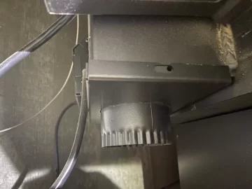

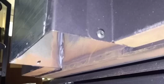

i just got the same part from Hechlers. On my stove I wrapped the 3 sides around the outside of the box, and the 4th side (the front) goes inside the box.
This is before and after. I haven’t put the screws in yet. I hope this helps (and is correct).
549CBE42-6DC5-4AD4-9479-9D189B208F17.jpeg 84A8FE3D-9DB0-4FCB-9D3D-CB01DFC3A258.jpeg
Reactions: edward7 and BKVP
BKVP
DonTee has correct install. When the main air channel is welded to the stove, it can distort slightly. You'll note the four FA adapter flaps are not welded. Installers simply use pliers or ball peen hammer to widen the stance of the flaps. Remember to remove screws shown in picture before trying to attach.
