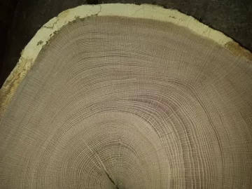

Side note...This past weekend I cut on a top of a white oak that blew out about 2.5 years ago and it is still incredibly wet. 24" rounds at about 200 years old from 30 feet up. Long lengths of white oak don't dry from the sides:confused:
