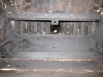

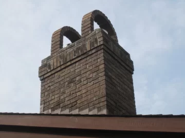

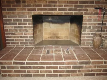

Thanks for quick answers. Posted pics I forgot in original post. Any additional thoughts? I will have to remove brick arch and reinstall. #6 was companies listed that sell caps-any comments. Do you think Olympia will sell to me?-I have yet t call them?
You could probably do it with them inplace. What are they for i have never seen that before. As far as the cap just use the cap that goes with your liner system. And no olympia will not sell directly to you unless they have changed that policy to but i don't think so.
Arches just for looks. There are two round flue liners in the chimney with an arch directly over each flue. I am only lining one. I will call Olympia anyway to ask about other products the sell. Many thanks and I will seek your input with specifics as I proceed.

Saw video of double liner install in UK on another post. They show using clamp on top of top plate. They also show using a short reinforcement sleeve inside top of liner to keep from crushing liner with support clamp. I have not seen this as a part provided in kits I have reviewed. I called Olympia to get info about my Armor flex liner preference and can't get access to website for more detail on parts needed to complete my install. What is that part called? Also you recommend using SS screws or rivets to reinforce hold on liner at the clamp connection. Which do you prefer and do they get in the way of placing cap into position? Also I assume the storm collar fits over clamp and is tightened and silicone in place before cap goes on. In addition to the liner and insulation kit I intend to buy a cap (can other brand caps work as I am not liking what I see provided in the Olympia kit and can't get to catalog to see full line of product choices), storm collar, support clamp, heavy top plate, stove connector (don't know what angle). I need to remove part of existing cast iron damper and brick at rear creating the shelf. I intend to remove only as much as needed to see if I can re-use old damper plate to help provide for a modified block off plate or at least support for a new one created from scratch. Good idea or not? Also given the weight of liner (6" X 20') would it make sense to buy and extra support clamp like one used at top to add additional support at the damper area assuming I can save enough of the existing cast frame to attach to? Again, would you use rivets or screws and would this compromise the liner to allow smoke/liquid leaks. Thanks for you help!
I have never seen that before either but believe me if you are using armor flex you don't need that. Armor flex is very different from the liner they are using you will not crush it.
