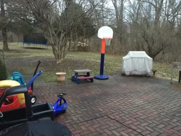

No. Down in my den that sits on a concrete slab with a walk out sliding glass door to my wood pile out back. Here are a few more pics for a better feel of the layout.
The chair, computer desk, and plant rack will all go away. Stove will sit there in the corner.
