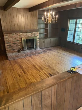

I have to take a pic of attic. But can’t get into house for a few days. Here is a pic of fireplace. I thought I could just remove that old insert and have a regular masonry fireplace to do whatever I want. Wood stove. Wood insert etc.
But as soon as you go in the crawl space above that room all that there is a pipe that goes out roof. On top of roof you have a brick chimney. appears to be a prefabbedchimney? Any idea what my options are? Wood love to get a proper wood stove in that room.

Sounds like an early zero-clearance fireplace. Why the wide hearth with the offset fireplace location? Does the other chimney run up the large blank area to the left of the fireplace?
Good question. I think it’s a run for HVAC. I have to check. That would suck if it is. Cause I won’t be able to rip that whole thing out. Ideally I would rip the whole thing out and put a free standing wood stove or even a freestanding gas stove.

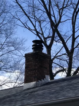

I won’t be able to get in house for a week to check and take pics. But for conversation sake, let’s say its a ZC prefab. And behind that brick facade is a chase that goes up to the ceiling to crawl space/attic where it’s just a pipe out the roof. On roof you have a masonry chimney (pic below).

I'm not sure that is a full masonry chimney. It might just be brick veneer.

Simplest option might be to build out a hearth pad for a freestander on the floor in front of the current hearth and rear-exit from a stove to a tee and an insulated liner.
